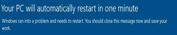

    since 05.07.2020 my Laptop HP Pavilion always reboots with the following message:
    A critical system process, C:\Windows\system32\lsass.exe, failed with status code 1073741819
    Sometimes the user cant login and there is only the login button and nothing else is possible.
    Sometimes there is the messsage "Error while login with service local session manager". RPC Server is not availible.
    I think the error with the RPC Server is just a result of the real error.

    When windows safe mode with network settings is started up and I activete the network adapter in device manager again everything works also fine until I add a wired LAN Connection. When the laptop is online blue message appear that I need to restart my computer.
